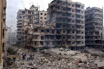

OK, you should really start all projects with a realism check. I looked through various sources at rubble and broken buildings. Taking into account the spread of derbis and the materials that make it up. Looking at the image below, you can see this close up not only has broken masonary in it, but also other objects that may have been held within the building, or on the street outside. Items like these add character and life to your models, putting them into a situation rather than on a plastic disc.
Watch for the spread of debris, is the rubble fresh or has it been there for years, while forces battle over the area. Areas further from the blast site will, obviously, be less covered with the debris, but rubble may have been cleared by occupants to provide additional cover or allow access.

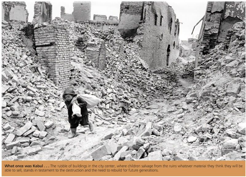

Note the cleared pathway on this photo

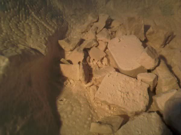

Next step. Wrap up your newly cast pieces in paper, I used kitchen towel but newspaper will do fine. Take these pieces outside and give them a good old whack or two with a hammer. The bigger the better! You want these to look like broken pieces of masonary, walls and what nots.
I then applied PVA glue to the base in areas I wanted large rocks and started to stick them down. I placed smaller pieces around these to give a sloped feel. I dropped a tiny amount of superglue over these pieces to ensure they stuck frmly to the base.

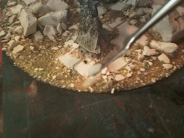

Next I got some of the smaller pieces of my broken up rubble and popped them into a spray lid. Then I crushed them up. Id advise using anything firm to do this with. I used a screwdriver handle. Leave some reasonable size chunks to scatter onto the base.
Next add some fine sand to this mix. You want about 60:40 sand to plaster. Make sure you mix this up well.
Now add some PVA to the uncovered areas of the base and around the lower areas of your large chunks. Then sprinke this mix generously over the areas. I covered my base in small sections at a time as its so large. With small bases you may be able to dip them into the mix, which will save on cleaning up time later! I made a mess!
As you do this leave the area to dry for a short while before tapping to remove the excess. With small bases you can do this on the side of the mixing pot to save making a mess all over your desk like I did! Also scrape of any of the mix that finds itself over the edge of the base, or any chunk of plaster that is over hanging too far, these may break off during gaming or in transit and can damage the base.
